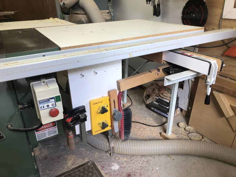

Luckily, I had already made a blade holder that houses about a dozen blades, so that got put in place quickly. Dado shims, a large wrench for changing blades and throat plates live in this blade holder, along with an assortment of blades. And most of my push sticks go on top of it. I mounted a small piece of particleboard near the on/off switch, and hung a few clamps, featherboards, etc there, all out of the way but still easy to grab. Jigs live on top of a shelf, just above head level, as most of them don’t get used too often. My miter jig and crosscut jig are the exceptions, as they get used often. They sit nearby, ready for action.
I also added a simple holder under my extension table to store my rip fence when it wasn’t in use. And attached to its underside is another cleat that holds my miter fence. Having an out-of-the-way place for these types of things proves handy when I’m not using them, as they otherwise are large and heavy and just get in the way. And if they were dropped or pushed off a surface, they would get damaged or maybe even hurt me.

Near the on/off switch I have a few miscellaneous table saw accessories, and a bit farther away is where I keep my rip fence and miter gauge when not in use.
