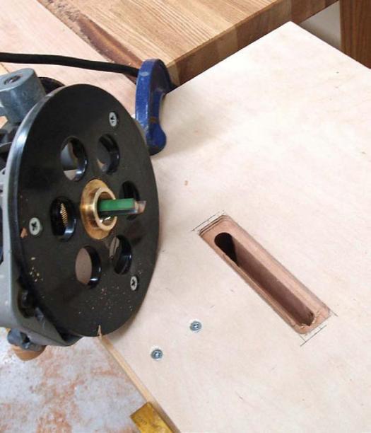

Mortising legs
 Using a guide bushing is a simple and effective way to get accurately placed mortises.

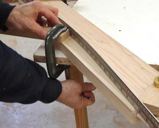

Drawing the arc
 This low-tech method of marking arcs is perfect for this application.

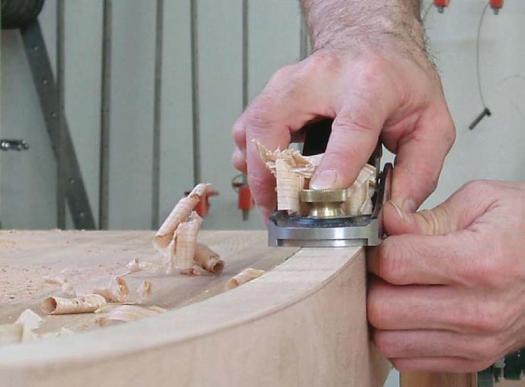

Hand planing a curve
 A flat-soled small plane can be skewed to work a gentle inside curve. However, the first choice would be a compass plane.

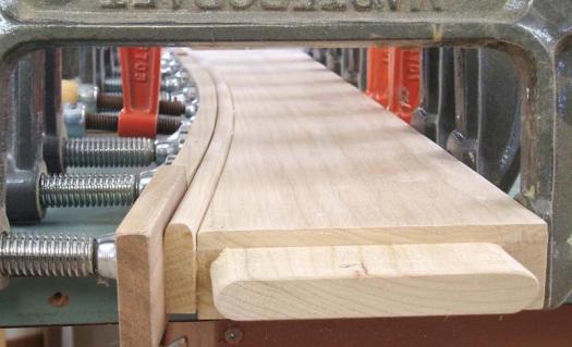

Clamping the bead
 Don't be afraid to bring out all your clamping power when gluing on a curve – in this case, more is better.

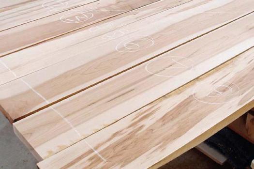

Laying out boards
 It's important to strike a balance between esthetics and wood movement – choose the position of the boards carefully.

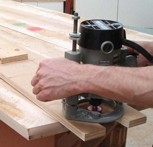

Routing the table top arc
 Take small bites with the router to ensure a clean and burn-free cut.

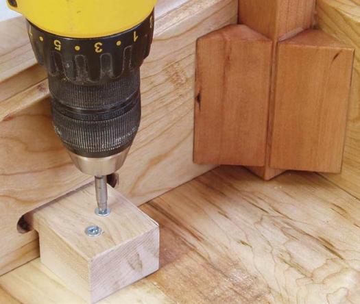

Attaching the top
 Choose your screw length carefully to avoid breaking through or telegraphing the screw tip.

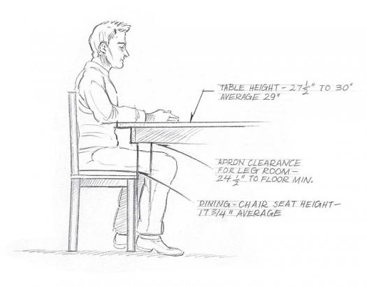

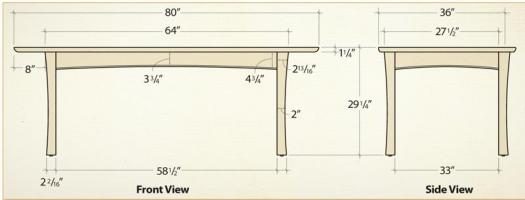

Dimensions for a Dining Table
When building a table there are a few dimensions you should keep in mind for function and comfort’s sake. The most important one is the overall height of the table. A dimension between 29″ and 30″ is standard. This height will not only be very comfortable and familiar for the vast majority of people, but it will also work well with the standard chair height.
Another dimension to keep in mind is the distance from the floor to the under­side of the apron. If this dimension is too small there will not be enough space for people to put their legs underneath the table. If it’s too large you may have trou­ble making the table strong and stable. A height of 24 ½” to 25 ½” is standard.
The final measurement that you should consider before making any sawdust is the overall dimensions of the top. If the table is going to go into a small room you don’t want people to have difficulty sit­ting down and getting up from the table because a wall is interfering with a chair. A comfortable minimum space between the table and a wall is 36″. This will allow everyone to have access to the table eas­ily and whoever is serving can have full access to the table. If space is really tight you can reduce this distance to no less than 24″, but realize that it will not be as comfortable and welcoming for everyone. Dining tables are usually between 36″ and 45″ in depth, while the length can vary to suit the room or the number of guests you expect to host.

The mortise and tenon joints that will se­cure the apron to the legs need to be strong to keep this table together. The mortise in this case, should be 3″ in length and needs to stop at least ½” from the top of the leg (don’t forget about the extra 1″ we left on the top of each leg when planning to cut this joint). Each tenon should have a shoulder of at least ⅛” so when assembled it can seat itself against the side of the leg. This is where the model leg comes into play. By using it, and a model apron, you can get a better idea of where the mortises need to be. Start by drawing the top view of one of the legs, with both mortises.
I use a plunge router equipped with a spiral bit and a brass template guide. The template guide runs in a groove I machine into a piece of ¼” plywood. I attach a couple of cleats to the plywood so the groove will be positioned directly over the mortise location and I clamp the plywood to the leg. The template guide fits the groove with absolutely no sideways movement, so the router can move back and forth to create a perfectly straight mortise. The mortise depth is limited to the length of the bit. That’s the reason I use thin ply­wood. Anything thicker would just take away from the depth, and therefore strength, of the mortise.
When you’re confident about location and depth, machine the eight mortises on the in­side top faces of the legs. Now you can cut the legs to their final length of 28″.

The arc on the underside of each of the four aprons can now be drawn onto the aprons with the help of a flexible straight­edge, three blocks and clamps. The arc is 1″ narrower in the center of the apron than it is at the edges. Cut the arc with a bandsaw or jigsaw, but leave about 1/16″ of material on the apron to work with. Because there are only two aprons of each size, (two long aprons and two short aprons) I don’t go to the trouble of mak­ing a pattern for my router table. I find it easier and quicker to use an assortment of planes (depending on how tight the ra­dius is) to take the high spots down and fair the curve by hand. The ideal tool here would be a compass plane but, by skew­ing a flat-soled hand plane, you can plane to a slightly tighter curve.

Before gluing the beads, sand the front underside corner of the aprons to break the edge. You will need a caul long enough to cover the entire length of the apron and all the clamps you have…may­be more. Apply glue judiciously to the underside of the apron – any excess glue will squeeze out and may cause problems down the road. You can use a finish­ing nail to tack the bead in place, then, with the caul, start applying the clamps. I routed a quarter round in the back of the apron. This cove will feel a bit better on the hand if someone reached under and grasped the underside of the apron. Remove any glue squeeze-out with a sharp paint scraper. Cut the overhanging bead to length using a fine handsaw so it’s flush with the shoulders of the tenons.

Cut the boards to rough length then joint and plane them to within ⅛” of their final thickness. Lay the boards flat so you can see what grain and colour you’re dealing with. You will want to ori­ent each board so it looks good beside its neighbor. You also want to keep growth ring orientation in mind. With a large solid wood top it’s important to alternate the growth rings to help keep warping to a minimum and to ensure that your top stays together for years to come.

A 9′ radius needs to be cut at both ends of the top. To do this, attach a board to the underside, middle of the table top. Attach a long circle cutting router jig to this board. The jig can be made of a couple of pieces of ¾” plywood that are attached together. Simply secure a router to one end with the bit protruding through the jig. Make sure you attach the jig to the first board so the center of the arc is aligned with the center line of the table. Also make sure that there is 9′ be­tween the inside of the bit and the center point of the arc. With small passes rout the arc into the end of the top. Repeat the same process to cut the arc on the other end.
Feel free to use your own imagination to come up with an edge profile. I used a large round-over bit (about 1½” radius) with a bearing to rout the underside of the top and a small round-over bit (3/16″radius) to rout the top edge.
After some hand planing and lots of sanding with a belt sander and sanding block you are ready to attach the top to the base. Flip the top upside down on a workbench. Make sure something soft – some carpet works great – is between the top and the bench so you don’t scratch the top surface. Center the base over the top. Secure the base to the top by insert­ing some #10 screws through the solid cleats. You will have to drill a pilot hole in the top to avoid splitting the top. When driving screws into the top make sure the screws are the right length. You don’t want a screw to poke through the top, ru­ining a beautiful surface. You also don’t want to use a screw that’s too short, as it will not provide enough holding power. Aim to have the end of the screw stop between ¼” and ⅜” away from the top surface. Last, but not least, install an adjustable leveler foot centered on the bottom of each leg.
