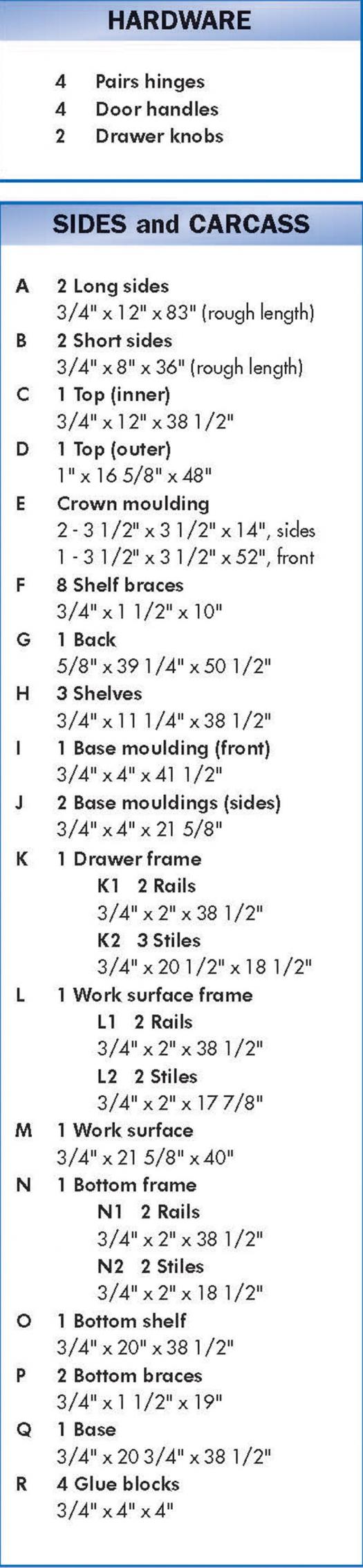

The Carcass
•   Mill stock for the sides. Each side is made from one long board (A) and one short board (B) biscuited and glued together. Use stock a little longer than the finished dimension, then trim to size after glue-up. It’s safer to trim the sides using a circular saw and a length of plywood as an edge guide, rather than trimming it on your table saw.
•   Use your table saw or router to mill a ⅜” wide x ⅝” deep rabbet on the back inside edge of each side. This will house the back (G).
•   Mill stock for the inner (C) and outer (D) tops. When assembling the carcass you will screw the inner top to the sides, and outer top to the crown moulding (E).
•   Mill stock for the top shelf braces (F), and the bottom braces (P).
•   Attach the top and bottom braces to the sides using #8 1″ screws. Counterbore the screw holes and cover with plugs.
•   Mill stock for the three upper shelves (H) and the bottom shelf (O).
•   Mill stock for the base (Q).
•   Cut four glue blocks (R) from scrap plywood.

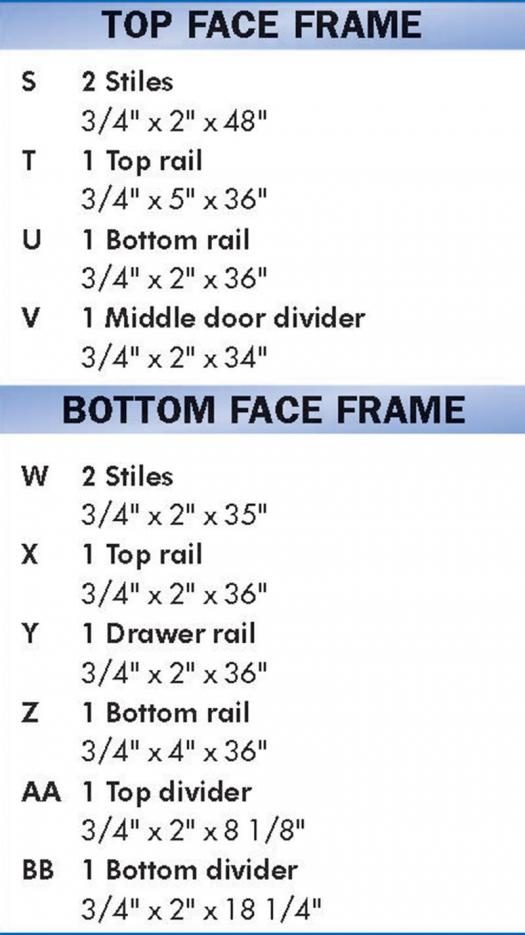

Face Frames
There are upper and lower face frames on this cabinet. As for the internal frames, it is easier to mill the stock for the face frames at the same time.
•   Mill stock for the top (S, T, U, V) and bottom (W, X, Y, Z, AA, BB) face frames.
•   Biscuit the frame together, allowing for a 1/16″ overhang on the sides, which you will plane flush afterwards.
•   Prepare the stock for the skirt moulding (I, J). Once the carcass is assembled you will mitre the ends and glue it over the face frame and sides.

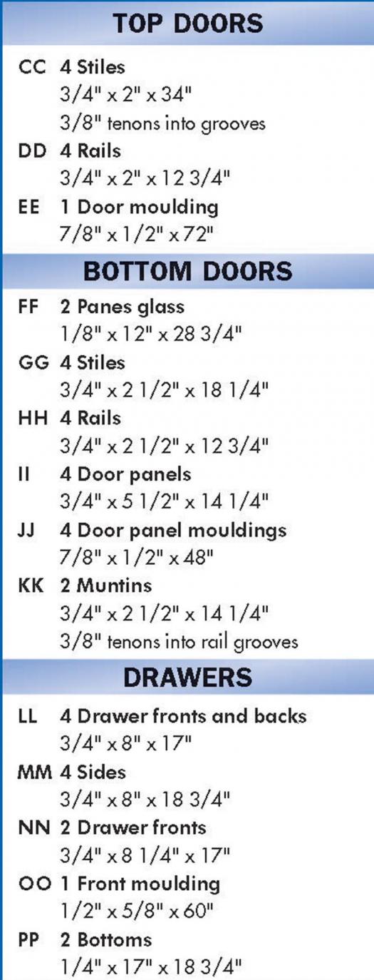

There are two sets of doors – glass doors on the top, and frame and panel doors on the bottom.
•   Prepare stock for the top door stiles (CC) and rails (DD).
•   You can use mortise and tenon, slip, mitre, or butt dowelled joints to assemble the frames.
•   The doors do not have glazing bars. Use a router or table saw to cut a ⅛” x 5/16″ rabbet along the stiles and rails.
•   Slip a single pane of ⅛” glass (FF) into each door frame allowing 1/16” for wood expansion.
•   The applied moulding (EE) will secure the glass in place. Make the moulding by routing your favourite profile on both sides of a ⅞” x 2″ board. Then, rip ½” mouldings off each side. As required, use scrapers, scratch stock, or sandpaper to clean up the profiles. Mitre and fit the mouldings to the door frame and carefully pin and glue.
•   Prepare stock for the bottom door stiles (GG), rails (HH), and muntins (KK) using the same joinery technique as for the top doors.
•   Prepare stock for the panels (II).
•   Raise and feather the panels on the table saw using dado blades or use a panel raising bit on your router table.
•   Fit the panels in the French style (i.e. with the flat side outwards and the raised portion facing in).
•   Rout and cut the mouldings (JJ) in the same way as the top. Glue and pin the mouldings to the door frame. Be careful not to get glue on the panels, as that would defeat the function of a floating panel.
Drawers
•   Mill stock for the drawer fronts and backs (LL) and sides (MM).
•   Mill the bottoms (PP) from ¼” solid wood or cut from plywood.
•   Assemble by hand using dovetails or with a router using a drawer lock bit.
•   Apply a ½” quarter round moulding (OO) to the front.
•   Fit the drawer false fronts (NN) to the boxes using double-sided sticky tape or hot melt glue to get a proper fit. Then, screw false fronts securely from the inside.
•   Pre-finish the inside of the drawers with your chosen finish before assembly.

Hardware
•   Install hardware of your choice. I used cast iron transom-type latches on the doors and large brass shell pulls on the drawers, bought from my local hardware store.
