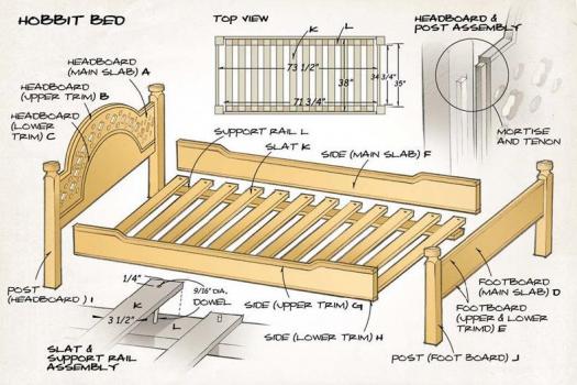

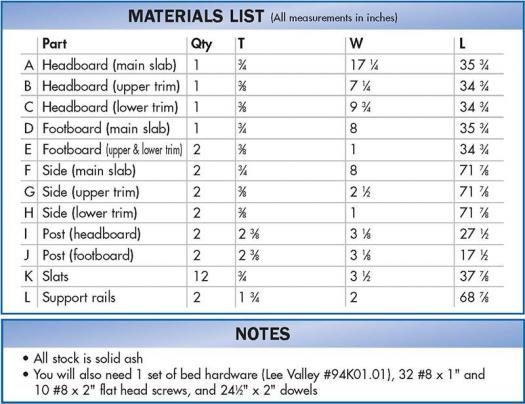

The Stock
• Mill and glue up the stock for all the major parts – headboard, footboard, sides (rails) and posts (legs).
• Make the parts about 1″ oversized, to be trimmed to final size later.
• Plane or thickness sand the parts to final thickness, about 13⁄16″.

Sides
• Make sure that everything is finish sanded, and then glue and clamp the posts onto the sides with bar clamps. Check for squareness.
• Cut 1½” x 2″ slat support rails for attaching on the insides of the side rails.
• Cut the support rails 3″ shorter than the finished length of the sides, which gives an inch and a half of clearance at each end for the hardware.
• After the support rails are cut to length lay them beside one another and clamp them together with a small clamp, just to hold them in place for scribing. Then mark the positions of the holes for the dowels, and scribe that position onto both pieces. It is important that the rails are positioned the same way that they will be on the finished bed – insides in and outsides out. This way there can be no mistakes, and the slats will fall nicely into place.
• Position the dowels about a ¼” in from the outside edge of the rail.
• Drill the holes using brad-point drills because they produce a cleaner hole. Clamp a long piece of plywood onto the table of the drill press to support the weight of the rail when drilling the holes near the ends. This ensures that all the holes will be exactly the same distance from the edge, and the fit of every slat will be exactly the same.
• Glue the dowels into the holes, leaving about an inch of the dowel sticking out, and then set up the table saw to trim them all down together to ¾”. Since the slats are three-quarters of an inch thick, the dowels will be flush with the tops of the slats.
• Round over the corners on the tops of the dowels with a file or chisel.

Slats
This bed is a European design with slats under the mattress instead of a box spring, making it both very strong and easy to disassemble.
• Mill 12 slats, making them 3½” wide, leaving a 2½” space between each slat.
• After the bed is assembled drill 9⁄16″ holes in the ends of the slats so they will easily fit over the half-inch dowels.
• Drill pilot holes for the bed hardware, then attach it with a couple of screws.
