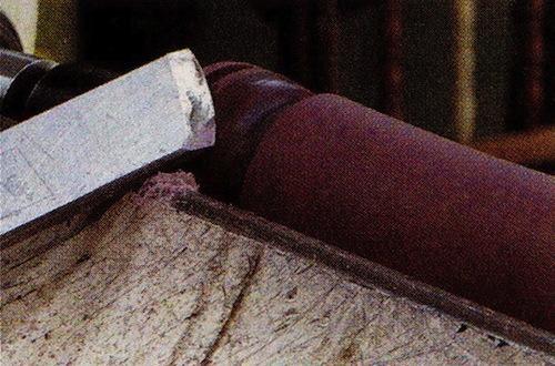

With the head in place take a light cut, tapering it down slightly. Then part the ends. The parting tool is really only good at removing wood, not at making a superb cut. The skew, on the other hand, is not really that keen on removing a lot of wood at a time, but superior at making fine finishing cuts where no sanding is required.

• Cut the transition from the head to the handle with a ½” spindle gouge, ensuring that the gouge travels downhill always. Next, shape the handle so that it pleases your eye. Finally, turn a bead at the end. At this point I sanded and finished using Mylands friction polish.
