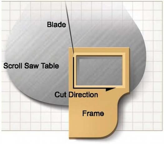

Table tilted to left by amount needed for the thickness of wood. Test-cut on a scrap piece of the wood to determine angle. Entry hole drilled in bottom of line and cut in direction of arrow all the way around.

You must tilt your scroll saw table to the left, to cut the outside line around the photo area (called a relief cut). That is so the piece around the photo area will pop up and lock in place, creating a recess in the back of the frame for the glass, photo(s), and cardboard backer.
The amount that you tilt the scroll saw table to the left will depend on the thickness of your project wood, and the size of your blade.
Test cut a piece of scrap wood to get the tilt right for whatever wood and blade you will be using.
I used ⅝” particleboard and a Flying Dutchman, #9 FDSR blade, size 0.050″ by 0.018″, with 8 teeth per inch. I tilted the saw table to the left 4 ½º, which gave me a ⅜” recess in the back.
Cutting the Frame
Tilt the table to the left. Drill a small entry hole (the same angle as the tilt) at the bottom of the pattern line. Cut in a counterclockwise direction until you get back to the starting point. The piece should now pop up and lock in place.

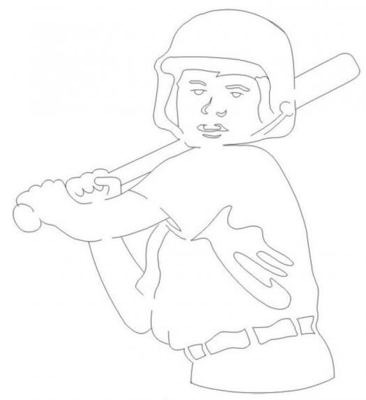

The figure of the baseball batter is cut from ⅛” Baltic Birch plywood, and glued on the frame as an overay. I left mine plain as it shows up better on the green background. The frame is first painted with Krylon spray paint. Then, the figure is glued on and the whole project is given 3 coats of a clear spray.
