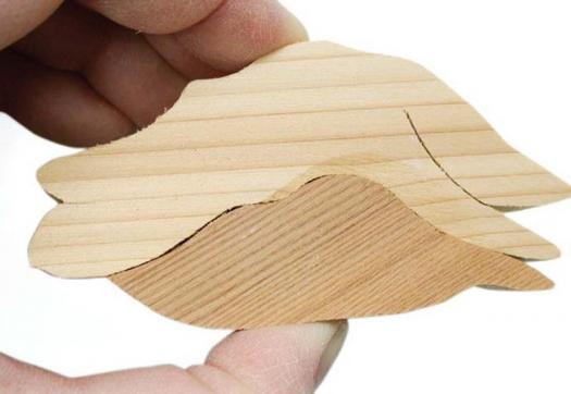

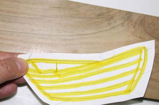

Match wood grain for boat
Glue cut paper templates on wood

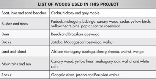

The selection of wood will have a tremendous impact on your project finish. ‘Pure’ intarsia is made by using woods in their natural colour (without applying a stain). I personally don’t mind using a little bit of stain or acrylic paint in order to get the colour I am looking for, or simply to enhance a specific area of the project. Sometimes, just a little touch-up can make a huge difference. In this project, I wanted to tint the lake, so I selected cedar for that piece, as it works great with acrylic paint. Along with colour, you need to consider grain direction. Different woods will suggest different kinds of movement. For the boat on the shore I selected a piece of grey maple that had the perfect curves in it, while for the mountain at the top, I used ash; its distinctive grain pattern suggested hills and valleys. Cedar and poplar are usually very good for suggesting water, while I have a preference for Brazilian lacewood for deer fur. Even though I have suggested some wood species you should make your own choices depending on the wood that you have at hand.

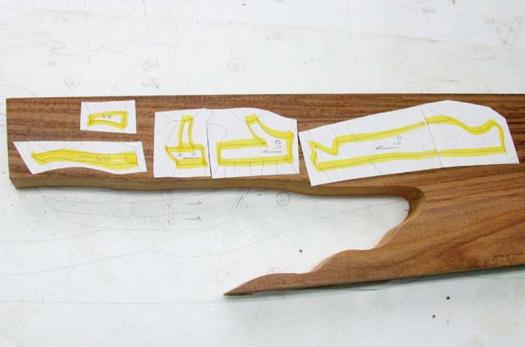

Rather than using the tracing method with carbon paper, I use the cut and paste method, gluing each pattern piece onto the wood, to eliminate tracing variations from the original pattern. I begin by using a yellow highlighter to mark the lines I want to cut on the pattern copies. This helps reduce cutting mistakes, as there are a lot of surrounding lines from adjacent pieces on the pattern. I cut the pattern pieces along the lines I have marked, and then I regroup them based on wood colours and thicknesses required. I attach the patterns to the wood with a glue stick or with spray adhesive.

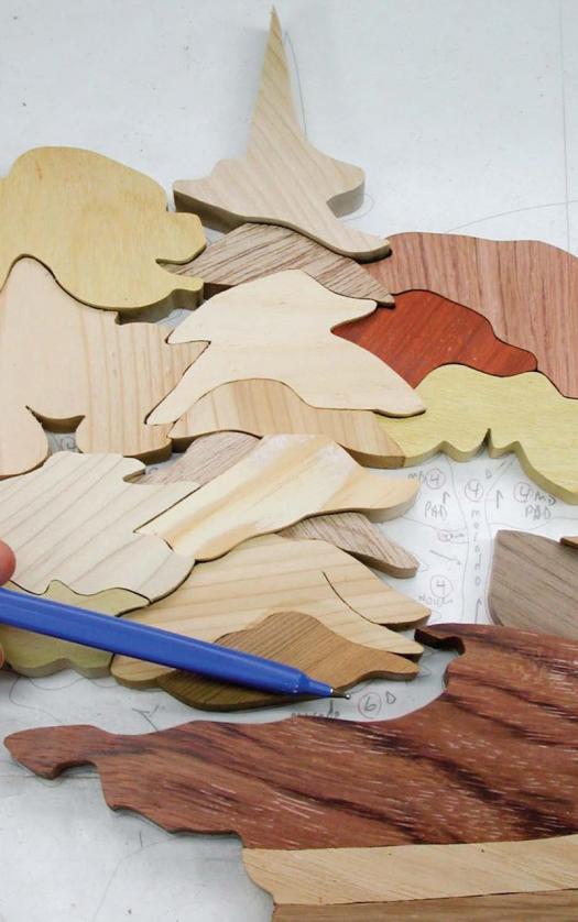

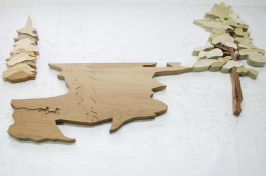

I like to cut many pieces of wood at the same time or even the entire project all together when it is not too complex. For a large project like this, I cut a smaller area first and fit the pieces tightly together before cutting other pieces around it. Breaking the project down into more manageable areas makes it less intimidating. I usually start toward the middle of the project and work my way out. In this case, I started by cutting the lake, the pine tree on the right side, and the fir tree on the left side. I worked around these three areas until they were all connected together.
Before cutting I identify the pieces to be cut at the end of the project – the buffer pieces. The idea is to allow you to redraw the buffer piece pattern using adjacent pieces already cut as guides to ensure a tighter fit. For example, on this project, I marked the piece at the bottom of the fir tree as the buffer piece. I started by cutting the trees, then I completed the area by cutting the buffer piece last.

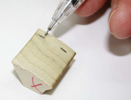

Sand the bottom of each cut piece to remove the irregularities (fuzz) left by the blade, and then remove the paper on the top surface with a sander. So that you don’t inadvertently get the two sides confused, mark the bottom of each piece with a red pencil, which will show up on both pale and dark woods.
Check the pieces for fit, ensuring that the edges are square. This is essential for a good fit. If a cut needs to be adjusted, you can use an oscillating spindle sander to make the cut edge square. Be careful if you use a rotary tool, such as a Dremel, as it is more difficult to keep the edge perpendicular to the wood piece. You may have to do a little bit of sanding here and there to improve the fit. Small gaps of 1⁄32” are usually acceptable as they won’t be visible on the finished assembly. A large gap equally spaced is much better than a gap that varies in width.

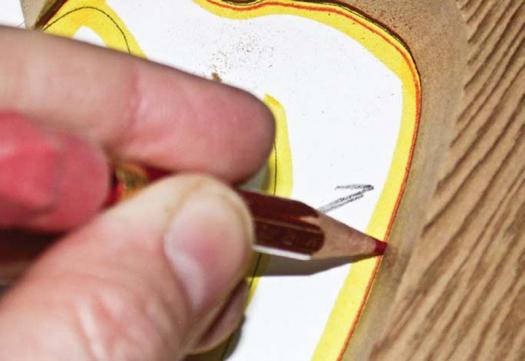

If you see that you have deviated too much from the plan, you can trace new lines based on the adjacent parts that are already cut (as I do for the buffer pieces). For better precision, I take a mechanical pencil with 0.5mm lead to make sure I follow the edges very closely. I also use a homemade light box, which makes it easy to see the gaps between wood pieces. I put the pieces on the light box, find any gaps, determine where I need to sand, and then mark the piece on top with a red crayon where it needs sanding. It is very hard to eliminate all the gaps.

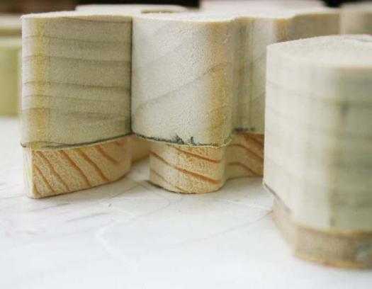

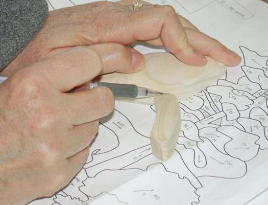

Once the pieces all fit together nicely, it’s time to raise or lower individual pieces where necessary. Shims can be made from any scrap wood, veneer or plywood, and are glued to the bottom surface of a piece. To lower a piece measure how much you want removed from the piece, place a reference line around the bottom of the piece, and use a sander to remove the excess material. It isn’t a good idea to shim contoured pieces as the shim will be visible from the side when the piece is finished. If you absolutely must shim, use a shim of the same wood species that was used to make your piece.

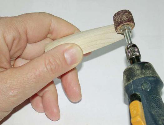

To remove a lot of wood fast you can use a belt or disc sander equipped with coarse sanding paper (60 – 80 grit). Complete the shaping using an inflated drum sander, or a rotary tool with a finer grit paper (100 – 120 grit). It’s good practice to frequently compare a piece’s thickness against the other pieces; this will help ensure you don’t remove too much material. Reference lines, which let you know when to stop shaping, are also a good idea. Identify the edges that should not be rounded on the pattern. Water is a good example. You don’t want to round any of the water piece edges. When you have a tree in front of mountains, you round the tree edges but not the mountain edges.
The more time you spend shaping your pieces, usually the better three dimensional effect you are going to get. Intarsia is not just a matter of cutting pieces and fitting them together like a flat puzzle. I used a bow sander to sand edges of narrow curves (i.e. the bushes). Once pieces are shaped, you may need to do finish sanding to eliminate any visible sanding marks. Remember to sand in the grain direction, progressing up to 220 grit, or until any scratches disappear. If you plan to stain the wood, this step is critical. The wood surface needs to be as smooth as you can possibly make it, as stain will highlight any sanding marks.

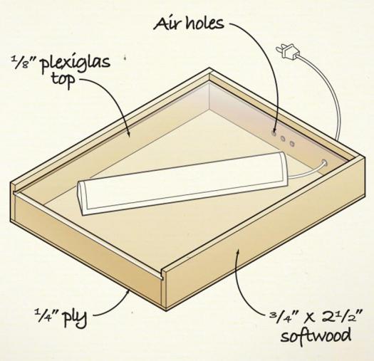

Light Box
A light box is simple to make. Make a frame of ¾” x 2 ½” softwood, the length of the pieces depending on how large a box you want. Using the table saw or router table, mill 3⁄16” grooves about ¼” down from the top edge on three of the frame pieces. The Plexiglas top slides into these grooves. Cut the top of the fourth frame piece so that it fits under the Plexiglas. To assemble the frame I simply screwed the sides together, and then screwed a ¼” piece of plywood to the bottom. I also drilled some air holes and an access hole for the light fixture cord.
