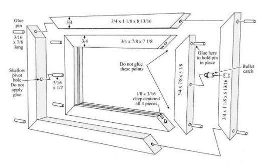

From the material list you’ll notice there are two widths of material used. The outer frame is slightly wider for stability. Prepare your pieces to the sizes noted on the drawing. If you don’t own a mitre saw, this is a good time consider getting one. A good mitre box or table saw mitre gauge would also do the job.
Lay the pieces into position and mark the corners so you will be able to put them into the same order later on. Next drill the 3/16” holes for the corner dowel pins. I have purposely allowed the glue pins to be seen after assembly. This adds a visual effect to the corners of the frame in addition to making it easier to install the pins.
There are a couple of ways to drill the holes. If you have a picture frame clamp, clamp one of the frames so that you have enough room to drill the holes in all four corners with your hand drill. I don’t have a picture frame clamp, so I drilled the hole in the end piece first. Then, with a little jig similar to a carpenter’s square that holds one corner at a time, I drilled the mating piece by drilling through the hole in the end piece.
Drill the holes for the pivot dowel and the bullet catch next. You’ll want the pivot dowel to stick out of the inner frame by only 3/16” and the mating pivot hole in the outer frame to only be 3/32” deep (the drawing says shallow). For the bullet catch, drill what suits it. I used a ¼” catch and had to drill a 9/32” hole. Figure that out! For the mating hole, match the bullet itself and stay shallow there, too. If you drill too deep, your frame will be loose. I only put an indent there at this point and did my “final adjustment” after I had the frames assembled.
