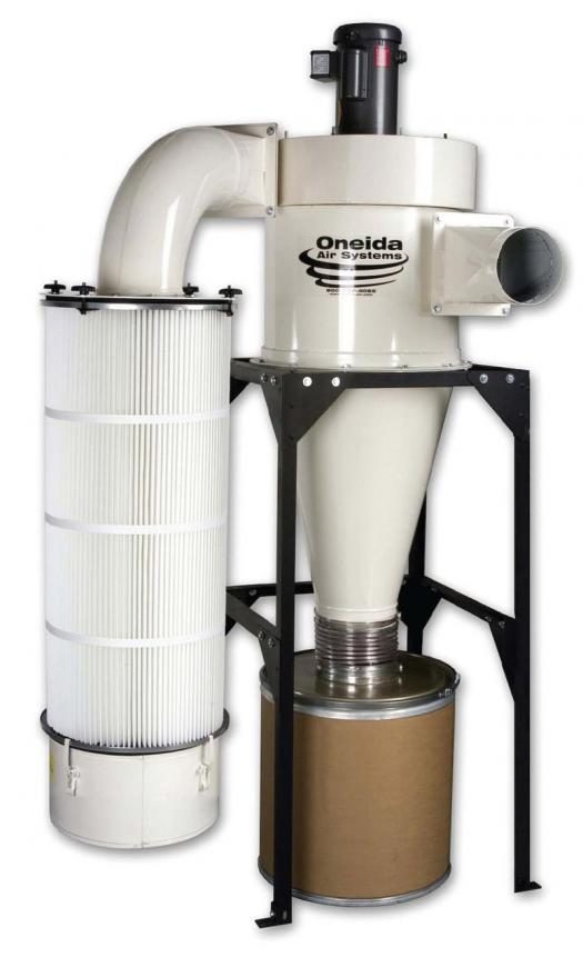

I knew from my previous set-up that I wanted a cyclone separator. Unlike single-stage collectors, these units divert the heavier material and dust away from the filter so it can do its job more efficiently. That capacity comes with a price though, and I don’t mean only money. Most cyclones are taller than other styles of dust collectors and my shop’s ceiling is 8′. I also needed to ensure my shop’s electrical system could accommodate the extra power requirements of the dust collector. For health reasons, I wanted a system capable of filtering out the dust particles most harmful to your health – those in the .2 to 10 micron range. Because I have a basement shop, a relatively quiet operating system was preferred, and of course, one that would be reliable. Finally, I wanted the system to have an easy-to-dump, relatively large capacity dustbin. After some comparative shopping I elected to go with the Oneida Air Systems Pro Series 1500 (oneida-air.com). The Oneida system met all my requirements (along with a five year warranty); and the friendly folks at Oneida helped me design my ducting system and answered my many questions. Oneida cyclones and dusting system accessories are also available from Welbeck Sawmill (welbecksawmill.com).

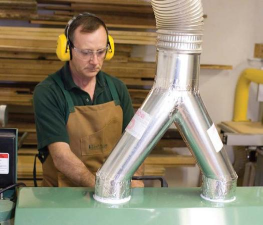

Installing the duct work was relatively straightforward but quite time consuming. I began by installing the rigid ducting first. I elected to start at the tool furthest from my dust collector and worked my way towards the dust collector, one run at a time. In all cases, I first layed out and assembled the required ducting components on the floor. For maximum airflow efficiency and quieter operation I oriented everything with the male ends aiming towards the dust collector. A friend helped me raise the runs into position one at a time and affix them temporarily into place before connecting adjoining sections. I opted to pop-rivet (three per joint) all components together, then sealed all joints with metal tape or silicone caulk in hard to reach areas. You don’t need to waste your time taping the snap seams on any of the snap ducting. However, the elbow ‘knuckles’ are potential air leak sources and need to be sealed. Speaking of elbows, try to keep any turns as gradual as possible; radii no less than two times the diameter of the ducting is ideal, as air velocity drops in tight turns, due to the increased SP. This may dictate that you use two 90º elbows at each corner, each set to approximately 45º. Similarly, never use right angle fittings, instead use 45º ‘Y’ branch fittings where possible.

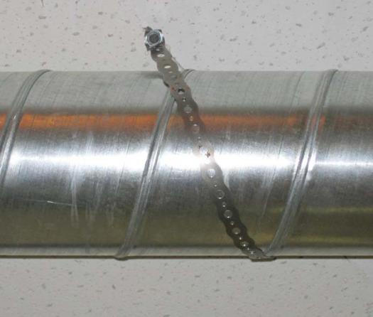

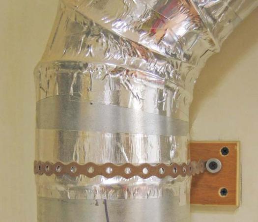

Once you have your first run temporarily mounted in place, move on to the next section. I used standard metal strapping and wood screws to fasten ducting to ceiling joists and the walls. As luck would have it, none of my wall sections ran near studs, so I made 3″ x 8″ mounting plates of ¾” plywood scraps, which I fastened to the walls using drywall screws. I placed these plates wherever things needed to be strapped down, such as where the ducting began its run down the wall and at air control gate locations.

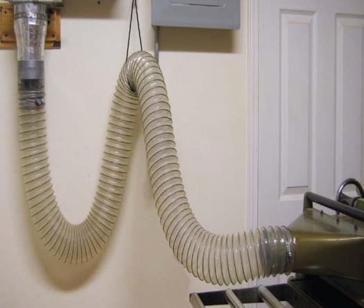

After I had installed all the rigid ducting and connected it to the dust collector, I turned my focus to hooking up the machinery. As mentioned, because of the size and configuration of my shop, I need to move my jointer and planer from their usual positions when milling long boards. On rare occasions, I also need to be able to move my table saw. Hence, these three main tools would be linked to the rigid ducting using 8′ flex hoses. Bear in mind that flex hoses provide considerably more SP than smooth walled ducting sections, so keep them as short as practical. For my other moveable power tools I outfitted them with quick connectors, to facilitate connecting them as needed to the dust collection system.

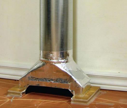

To deal with shavings and residual dust, I installed a floor sweep and mounted its air control gate just above waist level. These sweeps are relatively inexpensive. I highly recommend that you add one to your shop, as they really simplify clean up.
