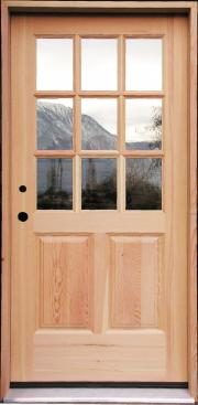

For a truly custom look that lends an air of uniqueness, and offers a warm, rich appearance, look to a wood door. There are two options: have a custom door shop build a door for you, or, build it yourself. Building a door is not overly complicated; however it does require that you are comfortable working with mortise and tenon joinery, have a good sized workspace, and a high level of precision in your woodworking. It’s definitely not a project for the novice woodworker.
Solid Wood Doors
Some of the more popular woods for doors are Honduran mahogany, white oak, Douglas fir, eastern maple, and cherry. Regardless of the wood you select, choose kiln-dried straight grained stock free of knots or other defects. Quarter-sawn lumber is a good choice. You’ll need 8/4 (2″) or 10/4 (2 ½”) stock in 8″ lengths for the stiles and 3′ to 4′ lengths for the rails. It’s a good idea to mill the lumber slightly oversize, sticker it and set it aside for a week or so to acclimatize it to the humidity level in your shop.
As with many large scale projects it’s a good idea to draw the plan for your door to scale. I use a scale of 1:4, and draw out each of the major joints full size.
There are a number of ways to build a door, but the easiest is using mortise and tenon joinery with a solid wood floating panel. Solid wood doors weigh quite a bit, so you will want to use joints that won’t come apart over time. You could use loose tenons, wedged tenons, or draw pegs on the M&T joints. Ensure you use waterproof glue (elmers.com) or epoxy (ecopoxy.com) on all the joints. An expansion gasket (atlanticgasket.com) will allow normal expansion and contraction, and eliminate moisture leakage while keeping the panel centered.
Entrance door
Photo courtesy of DouglasFirDoors.com
If you have access to a shaper, or a router table equipped with a 3 ¼ HP router, then you can use a raised panel bit to shape the panel and a profile bit set (busybeetools.com, vermontamerican.com) to shape the stiles and rails. An alternative is to apply raised moulding on the stiles and rails to hold the panel or insulated glass insert in place.
Before you begin building a door, purchase the hardware. You’ll need an entrance set, three hinges and chrome or nickel plated screws. For doors 1 ⅜” thick and 32″ wide use 3 ½” hinges, for doors 1 ⅞” thick and 37″ wide use 5″ hinges. For intermediate sized doors use a 4″ or 4 ½” hinge. Typically, hinges are placed 7″ from the top of the door, and 11″ from the bottom, with the middle hinge centered between the two. If you’re replacing an existing door you’ll want to use the same hinge placements on the new door.
