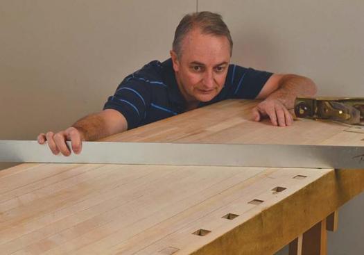

Check for Flatness
With a long straight edge, find the low spots. A light behind the straight edge will make life easier.

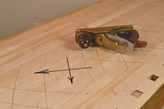

Mark the Surface
After having a good look at your bench, use hash marks to indicate all high spots. The arrows on the bench indicate the direction plane passes should be made while removing the high spots.

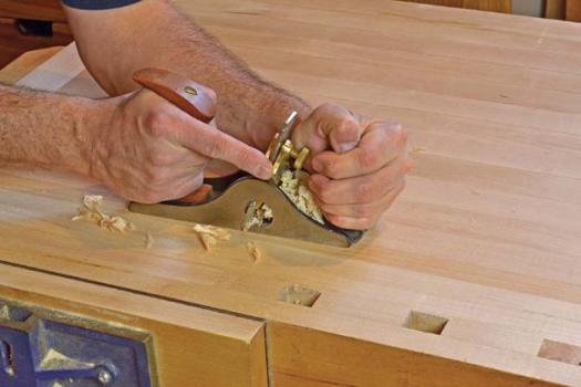

Consider a Scraping Plane
To reduce tear-out on tough areas, a scraping plane is a good option.

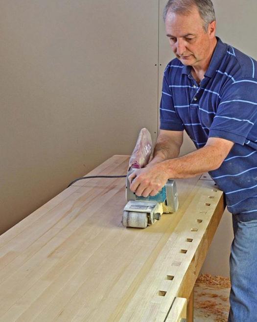

Add Some Power
A belt sander may be scoffed at by some purists, but if used properly makes fast work of smoothing a bench top’s surface.

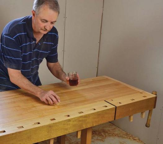

Final Touch
A mixture of Tung oil, double-boiled linseed oil and urethane is the perfect finish for a bench top. It can also be reapplied when needed.

To begin the process of flattening, first evaluate the flatness of your bench using a four-foot aluminum rule or similar straight edge. Use a strong oblique light and draw a circle directly on the bench top areas where the light passes under the straight edge, and hash marks where the straight edge pivots on a high point.

Initial flattening is done with the longest plane you have. A number 7 jointer plane will give you a long sole reference, and thus remove the high points while avoiding the low points. However, a reasonable job can be done with a plane as small as a number 4 smoothing plane. Begin by planing the bench on the diagonal, somewhere between 30° to 45° to the side of the bench. Make successive passes over the full length of the bench, overlapping plane strokes. Now do the same process from the opposite side of the bench, making diagonal cuts across the bench, at about 90° to the first set of cuts.
Keep checking with the straight edge to observe your progress. Re-mark the bench top to show high and low spots. Once the bench is relatively flat, it is time to begin planing parallel to the bench sides, down the length of the bench. The planks in the bench top will inevitably have some reversing grain, so you will have to deal with tear-out. If you are getting excessive tearout in specific areas, mark the area with directional arrows and plane them from the opposite direction to clean up the surface.
Another way to deal with tear-out is to employ a scraping plane. I prefer the scraping plane to a cabinet scraper because it cuts cleaner and it has a flat sole to keep it from diving into depressions. The scraping plane will clean up areas that resist your efforts with the hand plane. Just use the scraping plane in the problem areas; do not do the entire surface.
Reach for a Belt Sander
Once you are satisfied that the bench top is flat, you can save yourself some time by using a belt sander. (I heard that!) You can actually repeat the entire process with the belt sander if you feel you need to. The key is never to dwell with the tool, but to keep it moving.
If you need to do some fine flattening, begin by making passes on the diagonal, just as we did with the plane, but implement an oval motion, keeping the sander in motion all the time. Go to the other side of the bench, and make diagonal passes at 90° to the first pattern. Finally, make full-length passes with the length of the bench, overlapping as you travel the full length, back and forth. If the surface was flat after planing but suffered some minor tear-out, then go directly to belt sanding with the length of the bench. Avoid dwelling on the reversal of direction at the ends of travel. Use 100-grit sand paper to do the belt sanding.

Apply a Finish
Finish the flattened top with a mixture of oil and varnish. Mix even portions of semi-gloss urethane, double boiled linseed oil, and Tung oil. This mixture will give a deep, durable finish that you can re-finish every couple of years. The oil penetrates into the wood, while the urethane makes a somewhat liquid- proof coating. I put two coats on a bench. Apply the first coat liberally and let it sink in, wiping the excess finish off with the length of the bench. Allow at least 24 hours or until the surface is completely dry to the touch. Scuff the surface with 220 grit sand paper, and then apply a second coat. Two coats will seal the surface, without turning it into a slippery surface.
