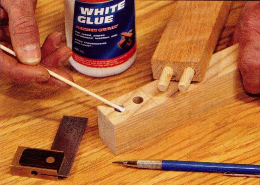

Dowel joints are an absolute joy to glue up, because the joint’s design only allows it to move in one direction – together. Unlike biscuits, dowels won’t allow the mating parts to move vertically or laterally during the glue-up. Provided that you drilled your dowel holes accurately, there is no need for ‘wiggle room’, which is often discussed in articles about biscuit joinery.
Drill your dowel holes deeper than the length of the dowels by at least 1⁄16″ on each side. This space is required for excess glue. Because you can’t compress a liquid, too much glue, with no space to go, will either prevent the joint from closing, or cause an absolute mess when the glue spills out around the joint.
If the dowels fit their holes snugly, as they should, then any glue placed on the dowels themselves will be scraped outwards along the dowels when you insert them. For this reason, you should apply glue only in the dowel holes. I like to squeeze glue directly out of the tip of my glue bottle (a round tip is essential) onto the inside perimeter of each hole. The glue will slowly seep down the walls of the hole in an irregular pattern. I then use a thin rod, and swirl the glue around the entire inside of the hole. If I’ve applied too much glue I’ll pull some back out on the rod, wiping it on a rag. Then insert the dowels one by one.
If by some chance the dowel holes aren’t of equal depth on the two mating pieces, be sure to tap the dowels in just far enough to leave 1⁄16″ of space (and glue) at the bottom. Hammering the dowels down all the way will force excess glue out of the joint while reducing the amount of dowel length for the other side of the joint.
Close the joint by hand if possible, or use a rubber mallet to coax it home. On wider joints where you might easily have four or five closely spaced dowels, be sure to close the joint evenly. Tapping on one side of the joint ahead of the other will cause a wedging action that makes the joint tighter than it should be.

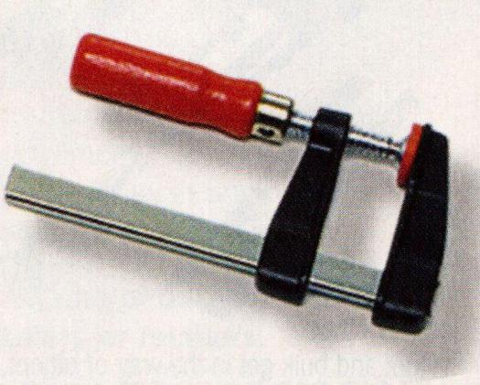

F-Clamp (Fast Action Clamp)
Similar to the bar clamp, but can be adjusted and applied with one hand.
