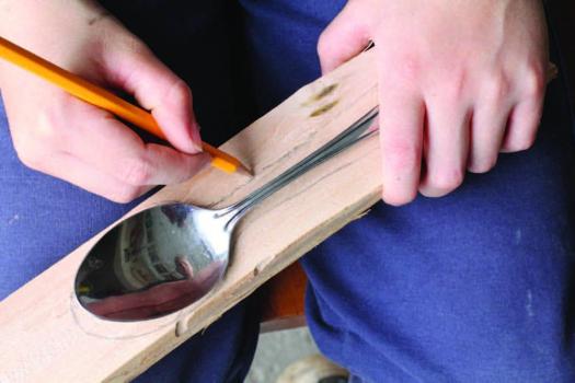

Copy Cat
There’s nothing wrong with finding a spoon you want to mimic, then tweaking the design to your liking. Brown and his son, Jonas, started with a metal spoon, then increased the width of the neck to make it stronger, and added an asymmetric handle.

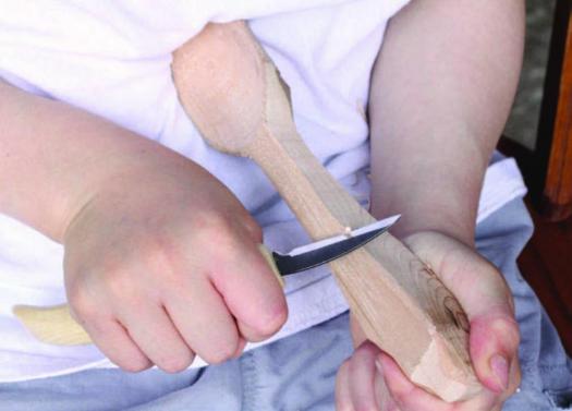

Elbow Grip
Probably the most natural for new carvers, the elbow grip can be used to remove many of the sharp edges. Watch a child for their technique, and don’t be afraid to encouragingly show them proper technique. The tendency might be for a child to remove too much material with each cut, so remind them of that, too.

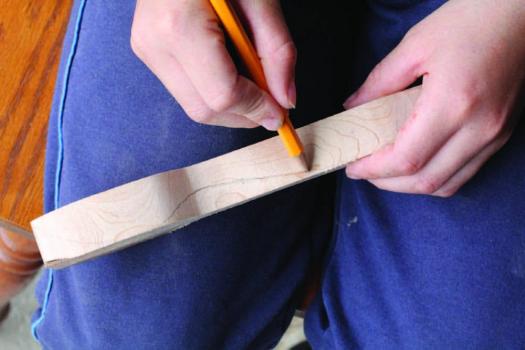

Uphill, Downhill
 Teaching a new woodworker about the difference between uphill and downhill cutting isn’t easy. Brown drew a line parallel with the grain, then positioned it level with the ground. At this point it’s easier to visualize uphill and downhill cutting by looking at the edge of the wood above that line.

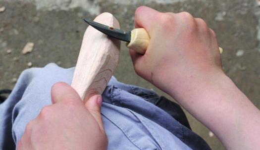

Pull Grip
 Working towards the body can be scary at first, but if someone is following good technique, this grip will make many carving situations easier. Remind the user to keep the tip of the blade pointed away from their body at all times, and show them that the heel of the hand or thumb should hit their body first if a cut gets away from them.

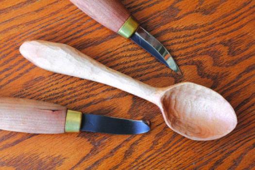

Apply a Finish
 Once the greenwood spoon was allowed to dry out, tung oil was applied to its surface. This helps protect the spoon from stains and keeps it looking newer for longer.
Design
We decided to make a serving spoon. I felt anything smaller might be too hard to hold, while something larger might be too much work, causing boredom and frustration. I was really just aim­ing for success. We used a metal serving spoon as a rough template, then beefed up the neck and added a slight curve to the handle. A straight handle would have been easier, but the boy wanted some curves in his spoon, and I didn’t want to disagree with his sense of style. The apple doesn’t fall far from the tree.

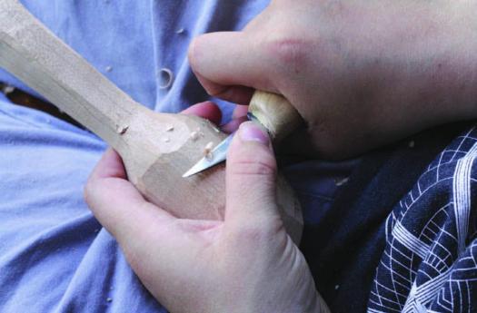

Reach for the knife
Jonas had already practiced grasping a knife and whittling a piece of scrap wood, so he was eager to put his skills to use on something practical. After a quick review of the elbow grip, he was off.
We focused on easing a lot of the right angles on the four cor­ners of the handle. He was soon successfully cutting “downhill” and, with less success, cutting “uphill.” With a short lesson on why it’s better to cut downhill, he was starting to learn some real carv­ing techniques. Soon, he was rotating the spoon and switching it end-for-end when needed in order to obey our “downhill” rule, and starting to naturally switch between grips, though a few times I had to stop him from doing something outside-the-box with the sharp knife.

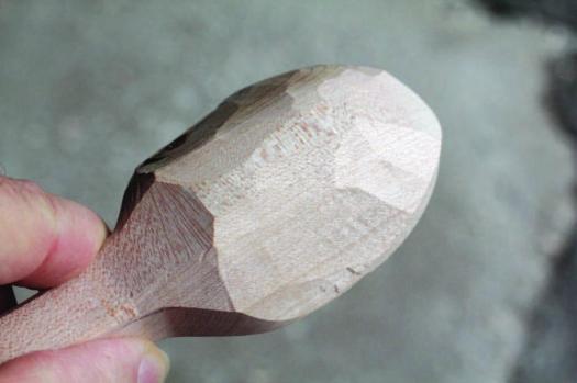

With the square cross section now eased to more of an octagon, we turned our attention to the neck and the underside of the bowl. This area is harder, as the turns are tighter. Switching between the bowl, neck and handle areas, we worked our way around the spoon a few times. Every so often I would ask him to pause, put the knife down, and not only grasp the spoon like he was using it, but to also look at it for any lumps or bumps that needed to be removed, before picking up the knife again. Having a narrower detail knife, as well as a standard knife, made dealing with the tighter curves a bit easier, but if you have only one knife, don’t let that stop you from taking on  this fun project.

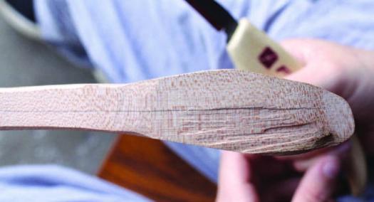

Jonas was now doing virtually all the work, but I felt the need to keep a close eye on his technique. His tendency was to remove too much wood with each slice. We talked about how that’s not only more dangerous, but will also leave a rougher surface. He also started to real­ize how much harder it was on his muscles to remove larger shavings.
The “uphill” versus “downhill” situation was starting to come fairly natural to Jonas, and the odd bit of tearout quickly reminded him of these guidelines, so I didn’t have to.

I found the initial hour or so was fairly easy, as the cuts didn’t need to be too accurate. Once the spoon was starting to look more like a real spoon, the knife cuts needed to be  more precise. The same grips were still being employed, but some finesse was needed when it came to using the grips to remove wood as desired. Rotating the spoon slightly, as opposed to moving the knife to a dif­ferent spot on the spoon, was something we focused on. Using the thumb push grip allowed for a lot of control at this stage.
It became extra tricky as we worked around the bottom of the bowl, as well as the neck area of the spoon. To demonstrate the small details of carving, I would stand behind Jonas (as he sat in the chair) and bring an arm around either side of him. This allowed me to show him the same view he would see while he carved. I slowly and clearly showed him how I would hold the spoon and the knife, and what motion I would use to remove the shaving.

Finishing touches
Because the wood was green, we let it dry for over a week after carving it, then applied two coats of tung oil to the surfaces, pay­ing extra attention to the end grain. When the oil had cured, it was time to celebrate. I said we should order a pizza with whatever he wanted on it, but he looked at me and said, “But then I can’t use my spoon.”
