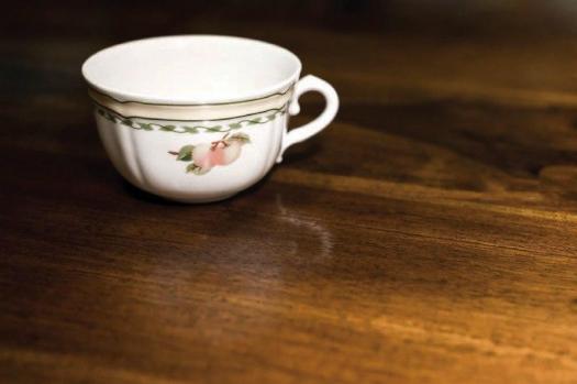

Heat and Moisture Protection
 Some finishes may need to stand up against heat and warm liquids, if they’re spilt. Certain finishes are great at this task, while others soften and discolour.

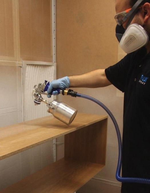

Safety Issues
Many finishes emit solvents, or other chemicals, once they’re applied. If you’re using a finish like this protect yourself and the environment with equipment like a face mask and spray booth. (Photo by Fuji Spray)

Almost all finishes, as well as the solvents and thinners we use with them, contain harmful chemicals. Some may have no immediate, apparent impact, while others can produce a temporary acute impact. Regardless, over the long term, repeated exposure to these chemicals can have irreparable, and often dramatic, detrimental impacts on your health. It’s wise, then, to consider that none of the finishing materials you use are good for your health. Protect yourself by working in a well-ventilated space. Ensure you wear a NIOSH-approved organic vapour respirator and latex or vinyl gloves when handling solvents and applying finishes.
Some finishing materials are also dangerous because of the flammability of their solvents, and may require specific storage and disposal precautions. Never pour solvents or finishes down the drain – store them in appropriate containers and take them to a recycle centre. Spread rags used to apply finishes in a single layer so heat dissipates while the material cures. After the rags become hard and brittle they can be placed in the garbage.
