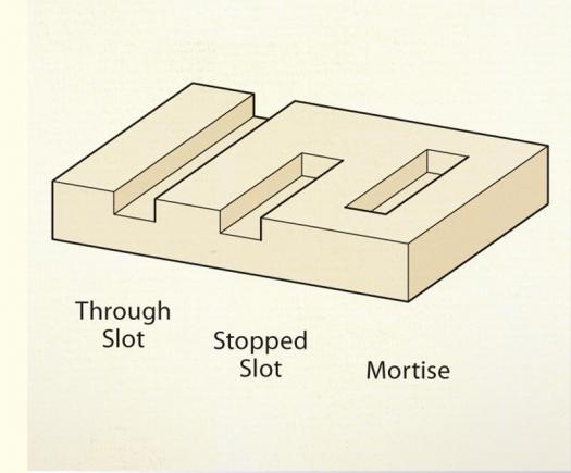

Because of their similarity, dados and grooves are often referred to as ‘slots’. The difference between the two is that a dado is milled across grain, while a groove is milled with the grain. The slot can run the full width of a board, it can be stopped on one end, or it can be stopped on both ends, in which case it essentially becomes a mortise. When deciding on the depth of the slot, use guidelines similar to that of mortise and tenon joints. When you mill a slot in a board, cut it approximately 1/3 the thickness of the board. You want to have sufficient material under the joint, as in the case of a bookcase, to support the weight of the loaded shelf, but not so deep that you risk weakening the receiving piece. The width of the slot will usually be the same thickness as the material that will be housed in the slot. In some instances you may wish to mill a shoulder on the material (e.g. a tenon) that will be housed in the slot; this serves to cover the edges of the slot, making for a cleaner appearance.
