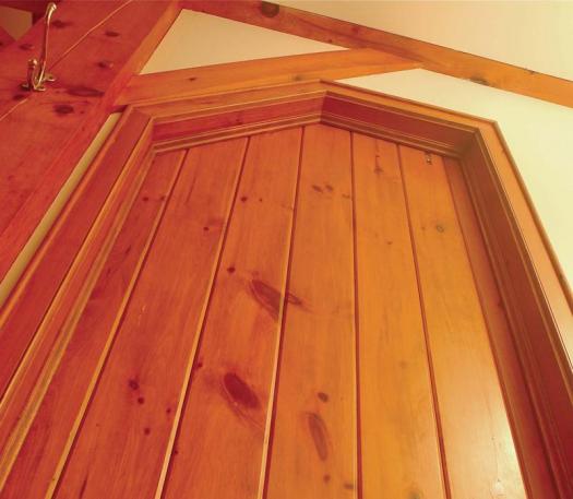

Simple solution
 Even with more complicated shapes to trim, this method makes quick work of trimming a door.

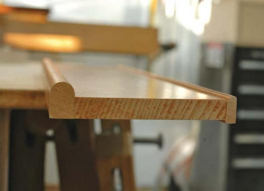

Easy yet elegant
 This relatively simple profile will make your doors and windows look great.

Instead of all this trouble, consider the advantages of pre-joining door and window trim permanently into three- or four-sided frames ahead of time, then fastening these frames onto the wall as a single unit. This eliminates any and every hassle caused by wavy drywall and out of square openings, while also allowing you to create absolutely tight and permanent corner joints in the controlled conditions of your shop using biscuits, glue and clamps. The only thing that stands between you and these obvious advantages is an approach to trim design that lends itself well to biscuit joined corners.

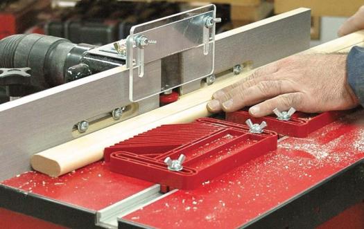

The nice thing about using flat stock for the main body of your trim frame is that the face can be sanded smooth and flat. Level up all joints after the glue has dried, then mill all the additional trim profiles you’ll be adding to the frame during installation later. Need some ideas?
A classic approach involves a ½” to 1″-wide bullnose profile capping the outside edge of the trim frame, flanked by cove moulding to cover the joint, with smaller bullnose capping the inside edge. You might also consider routing two or three flutes down the middle of vertical frame members, to add visual details. You’ll also find that Roman ogee and round-over profiles work well milled into thin strips that form the layered trim elements.

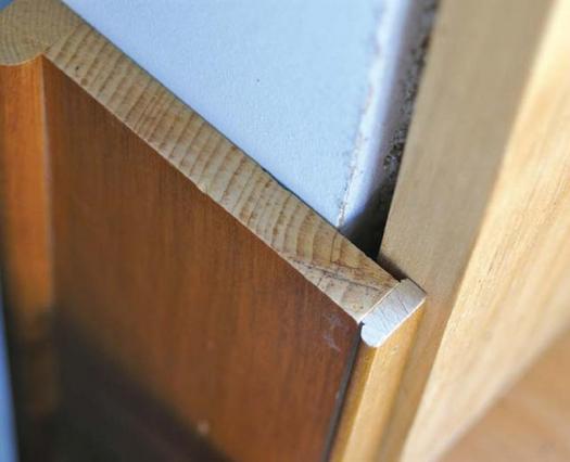

It’s not unusual for edges of door and window frames to not extend quite far enough out to meet the surface of surrounding drywall. This is a real pain because it means that part of the ugly edge of the drywall remains visible after the trim goes on. Unless you do something about it first, that is.
Instead of the huge and messy hassle involved in removing excess drywall or building up additional lengths of wood on the edge of the door or window frame, add a decorative strip to the inside edge of the trim frame, as part of the deal. Some ¼” or ⅜” diameter bullnose trim works perfectly here. It caps the edge of the trim frame, while extending down to meet flush with the face of the not-quite-long-enough door or window frame.

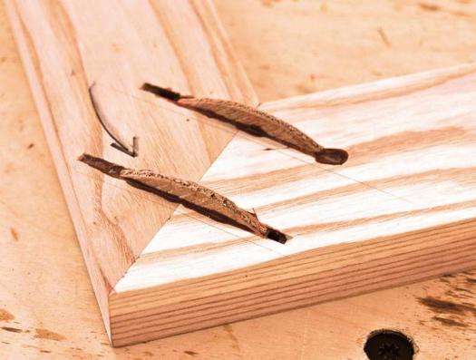

Use glue and clamps to join your profiled door and window trim into a frame without biscuits. Aligning the profiles perfectly is much easier since you’re not restricted in any way by a biscuit. After the glue has dried completely, gently flip the frame over (be careful, it’s not very strong yet), then plunge biscuit slots across the back face of each joint, at 90º to the joint line. Set your biscuit joiner for a deeper-than-normal slot depth, though not so deep that it comes through the face of the trim. Saw two, three or four slots across each joint (depending on the width of trim you’re using). Swab glue into the slots and onto the biscuits, then push the biscuits home. Let the glue dry completely, then saw and belt-sand protruding biscuits flush with the back face of the trim frame. Finish your wood, then install.
