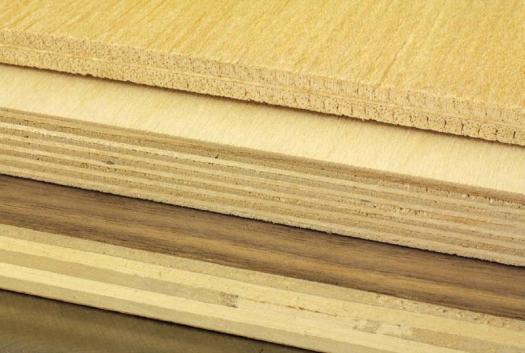

A Closer Look
Flexply (top) is fairly thin and flexible. It’s used in multiple layers as a core for curved parts. Baltic birch (middle) is a high-quality board with a higher number of plies than other plywoods. Standard plywood (bottom) is great for many applications. Here its face and back is covered with black walnut veneer.

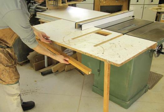

Out-feed Assistance
Brown hinged a simple out-feed table to his tablesaw that can be swung into position when needed, yet stays out of the way when it’s not in use.
Keep it Simple

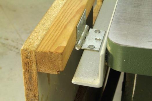

Standard hinges, some construction lumber, a 2x4' piece of 3/4" thick melamine particle board and some simple hardware is all that’s needed. The outfeed table has to be attached to each type of saw differently, depending on the type of rails on the saw.

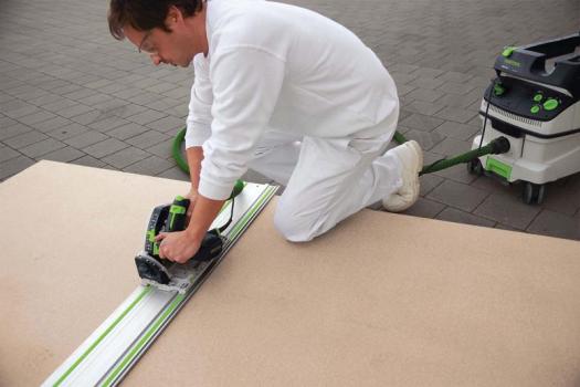

A track saw has many uses around the shop; it makes short work of sheet goods, and can help with angles if required. (Photo by Festool)

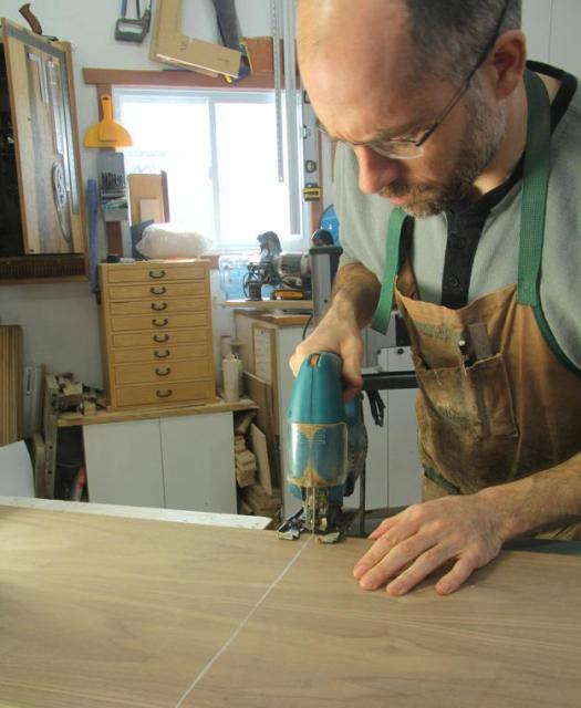

If all you need to do is break down the odd sheet here and there, keep things simple. After marking the locations of each part directly on the sheet with chalk, use a jig saw to make the cuts. Be careful of chipping on the upper surface, and work on the underside of the sheet if necessary.

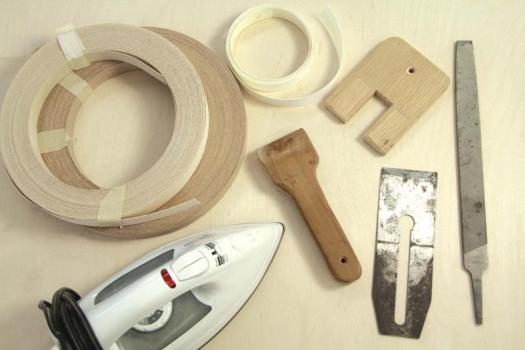

Iron-On Edging
A very simple approach to edging sheet goods is iron on edging. Although it doesn’t stand up to wear and tear, nor look as good as solid edging, it is fast and can be very effective in the right situation.
Characteristics
Plywood – Very strong, and is lighter than other sheet goods. It’s also on the more expensive side. It’s readily available in thicknesses from 1/4″ to 3/4″, and can be found slightly thinner or thicker if you look at higher-end suppliers. Economy-grade plywood is available, but it’s generally not as flat overall, and the surface isn’t as even as you may require. Quality plywood is available with veneered surfaces. Its surfaces tend to be more even than cheaper plywood, though it can still be far from flat overall. To keep plywood as flat as possible, keep it stored upright, or horizontal, with light pressure on both sides until you need it. Plywood holds fasteners like screws in its surface pretty well, unlike its edges, which may also split if you’re not careful.
Baltic Birch Plywood – Made with more, thinner plies than standard plywood and is generally higher quality than other plywood. There are no voids on the surface. It warps, similar to other plywood. Baltic birch plywood is sometimes sanded and finished for use as drawer boxes or other furniture parts.
MDF – Heavy compared to other sheet goods. It also has a very flat and even surface, which is great for veneering. MDF has mediocre strength when asked to hold fasteners in its face, and very poor strength in its edge. It will also drastically swell and weaken if it gets wet, so generally speaking, keep it away from bathrooms and kitchens.
Particle Board – Particle board is fairly heavy, flat and even, and is generally cheaper than most other sheet goods. Similar to MDF, it doesn’t hold screws in its face overly well, and poorly in its edge. It also doesn’t like to get wet. Particle board is usually what melamine surfaces are applied to.
Wiggle Board / Flex-ply – When you want to make curved panels this is a good place to start. With two thicker, flexible outer plies, and a thin inner ply, oriented at 90°, it will curve to a fairly tight radius. It’s usually about 3/8″ thick. These 4×8′ sheets are available in two types; one rolls into an 8′ long tube, the other rolls into a 4′ long tube, so be aware of what you’re purchasing.
Hardboard – Hardboard is similar to MDF, and generally quite thin (1/8″ to 1/4″). It’s cheap and flexible, yet rarely ends up as part of a quality piece of furniture; it’s great for making routing/shaping templates or for vacuum pressing platens. It’s really more of a tool than a material to be included in a piece of furniture.

The machine that’s typically used to break a sheet down to size is the tablesaw. As long as there’s enough space in front, behind and beside it, cutting sheet goods can be fairly easy. If you’re cutting a lot of sheet goods on your tablesaw an aftermarket rolling crosscut fence will help out a lot.
When I’m cutting sheets to size, I extend my 2×4′ out-feed table. It supports the material once it’s cut, making the job safer and easier. The out-feed table is hinged to the back of the tablesaw, and when extended, two simple hinged legs swing out to support the surface. It folds away when not in use. I routed two grooves in its surface so my crosscut sled and mitre gauge could be used when it’s up. The grooves weakened the outfeed table, so I fixed a couple of 36″ long 2x4s to its underside, which run perpendicular to the grooves.

A track saw is also a great option for cutting sheets to size. If you regularly cut a lot of sheets to size, this might not be the most efficient option, but it works great for smaller quantities. There is also nothing wrong with throwing a few pieces of rigid Styrofoam insulation on the floor, placing a sheet on top of it then using a circular saw to break the sheet down to size. Just be sure the blade will not make contact with the floor.
If you rarely cut sheets to size, there is a very simple, cheap option. Once you have the parts laid out directly on the sheet, use a jigsaw to cut the sheet down to size. Be careful of the chipping on the upper surface, and keep this in mind when laying out the parts. You will likely need at least one straight edge to eventually cut the workpiece to exact size, but this will only be a problem if you end up with a part that has no factory edge on it. In this case you can use a straight edge and a router with a flush trim bit to cut an edge straight on any part if necessary. This process is a little on the slow side, but if you rarely work with sheet goods, and don’t have the space or money for new equipment, it might be the best option.

Iron-on veneer or melamine tape is very easy to apply and most non woodworkers will never know the difference, visually. Iron-on tape doesn’t offer as much protection and artistic license as some of the other options though. It comes in rolls either 50′ or 250′ long and all you need to apply it are an iron and a push stick. To trim melamine edging, I use a somewhat dull plane iron or wide chisel, and just run it along the face of the workpiece. To flush trim wood edging, a file that is rectangular in cross-section and has teeth on its edge is used. Making swiping passes, with the file held on a slight angle, work your way down the edge. A light sand and you’re ready to finish the edge like the rest of the project.
