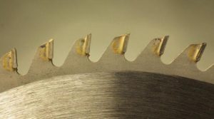

flat top teeth blade
Flat-top teeth (also known as ‘rakers’) are found on solid wood rip­ping blades. Since wood is much less likely to chip and splinter when it is being cut with the direction of the grain, the focus of a rip blade is to quickly and efficiently remove material. The downside of this blade is that it does not produce a clean cut. If you don’t mind a rough cut, a 24-tooth blade will do the trick. For a bit more precision, increase the tooth count to 40 or 50.

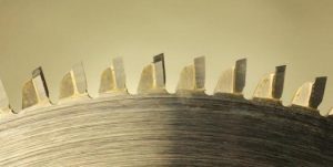

alternate top bevel teeth blade
“Alternate top bevel” means that the saw blade teeth alternate between a right- and left-hand bevel. This tooth configura­tion gives a smoother cut when cross-cutting solid woods and veneered plywood. The alternating beveled teeth form a knife-like edge on either side of the blade and make a clean cut. The teeth on ATB blades are angled so that they lean away from the blade plate on both sides, allowing the blade to shear wood fibres cleanly. Most ATB blades have between 40 and 100 teeth. Since a steeper angle means a more precise cut, some manufacturers have started to create a new category of blade: High Alternate Top Bevel (HiATB). This configuration is used for extra-fine cross-cutting and to cut materials surfaced with melamine, which is prone to chipping. The high bevel angle increases the knife-like action at the edge of the blade. The downside is that steeper angles tend to dull faster.
