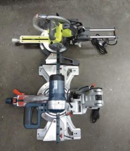

I tried all the saws with a dust extractor to see how they would perform. The Ryobi has a really well-designed dust shroud that seemed to get the most dust, while the long and bendy pipe on the Bosch did not seem to get much, although going to a more powerful vacuum definitely helped. The other saws were all about the same. I thought the Makita would be a lot better than it was with the two points of collection, but some dust still escaped onto the bench during use. Mitre saws need a pretty good vacuum to work effectively, but in all cases the vacuum seemed to get more than just the bag.
“Out-of-the-box” setup
It’s probably no secret that Makita got a lot of attention in the last year or so online with some models of saw not having the mitre detents set right at the factory. I think because one person checked their saw and talked about it, everybody started checking and finding that their saw was out, too. This is actually very common, even though it shouldn’t be. Of the five saws I tested, the Ryobi was the only saw that was right on out of the box – all the others needed adjusting. Some of the saws also required the bevel stops at 0° and 45° to be adjusted. None of the fences were square to the tables either, although the Bosch and Makita fences were very close, only out by 1 to 2 thousandths, while the Ridgid and Ryobi fences were off considerably more.

Space Issues – You can see how much less bench space “zero clearance” saws like the Bosch and Makita take, compared to traditional rail saws like the Ryobi.
