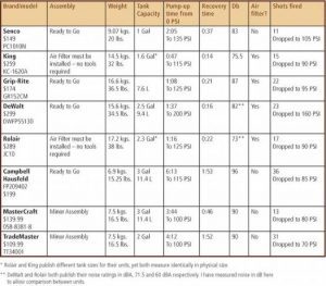

I wanted to test these compressors in a practical way that was mean­ingful to the average user. In the typical home shop or contractor application, the most common appli­cation for a compressor is to power a pneumatic nailer. One test I performed was to see how many “shots” could be fired before each compressor would cycle on. I also measured the dB rating, pump-up time from an empty tank, and recovery time. I also noted what pres­sure the compressor charged up to, and what pressure the tank dropped to before recharging. I believe that these statistics will be most relevant to readers.
Understanding the results
Pump-up and recovery times have been measured with a stopwatch. Pressure readings were taken with each unit’s own pressure gauges. It should be noted that this assumes each gauge to be calibrated identically. However, gauges do vary, so I would consider the pressure readings to be accurate to within 5 percent. For the “shot” test, I used the same nailer and hose hooked to each compressor. I used Grex’s 1850GB, which is a fairly powerful 18g brad nailer. The 1850GB has a fairly large cylinder to obtain its power, which means it will consume more air than most nailers. The point of the “shot” test is not to give an absolute number of nails to be driven by each compressor, but a rel­ative comparison between compressors. Using smaller nailers will allow the com­pressor to go longer between recoveries.
One of the most important things I dis­covered during the “shot” test is that some of these compressors drop well below 90 PSI before recharging. Most nailers are designed to run at 90 PSI. Running them below this pressure will result in a drop in fire power. This may result in fasteners not being fully driven with the tool. This problem will become especially obvious in smaller nailers that have less driving power to begin with. This problem will also be more apparent in hard woods.

There are a lot of factors involved in picking an air com­pressor. The choice made will be somewhat dependent on the intended purpose of the unit. If I was going to pick a unit to carry around all day, then obviously weight is a concern. If I was going to buy a unit that would stay in the shop, I may look at other features and ignore weight, knowing I would never carry the compressor. Looking over all the compressors, I think that the King KC-1620A represents the best value for consumers. The King has a quick pump-up and recovery time, is very quiet, and is at an attractive price. The King compres­sor gives me good value for the money spent. The KC-1620A is a bit heavy, so if you need a high level of portability, you may want to look at the Senco PC1010N. At 20 lbs., this compres­sor is very easy to carry around. It has a small tank, so it is not a good choice if you are doing a lot of nailing, but for smaller touch-up and assembly jobs it is perfect. For everyday use by a contractor on the job, I would pick the DeWalt or the Rolair. I like that the DeWalt works at a higher pressure. This means there is no worry about nailer malfunctions due to lack of air pressure. If noise is a concern, the Rolair is the quietest unit we tested.
